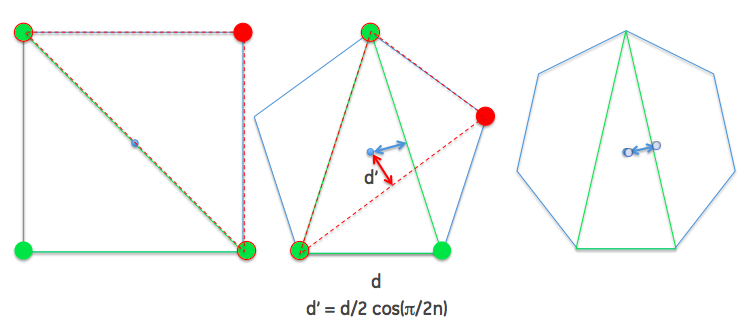

But there is another important factor (tip of the hat to my daughter for this concept): when the floor is uneven, a chair will be not be supported by all its legs - it will “wobble”. Now if you have four legs, this wobble will happen along one of the diagonals of the square, and this line will be below (or very close to) the center of gravity. That makes the energy needed to go from one side to the other very small. When you have five legs, the center of gravity is always displaced relative to the line of support. So five legs provide greater stability on an uneven floor. As you add more legs, the “diagonal of support” gets close to the center. Even numbered regular polygons always have the potential of having the line of support going through the center, making them the worst choice (incidentally this shows that a trapezoidal arrangement of four legs is slightly better than a square… you will sometimes see that, and now you know why).
enter image description here
All of that makes five the optimal number of legs - good stability in all directions. Note that from a construction perspective, it only makes sense to give a chair five legs when you start with a (metal or plastic) center post - the older (square wooden legs) construction makes four a more sensible number as the other answer stated. Once you want the chair to have vertical adjustment, a single center post makes sense - and then you have the flexibility to choose the number of legs.
