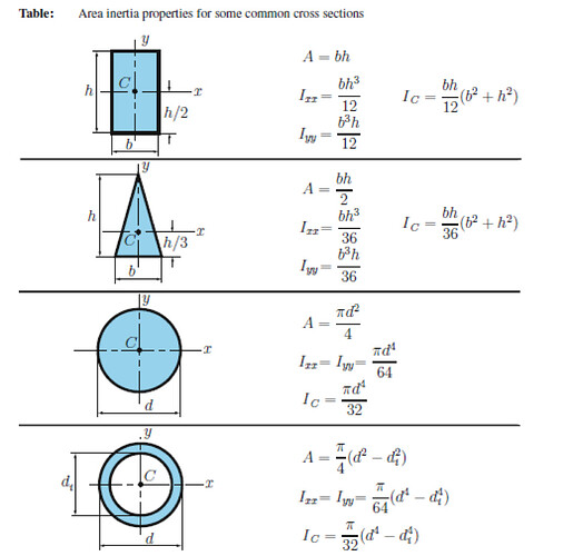

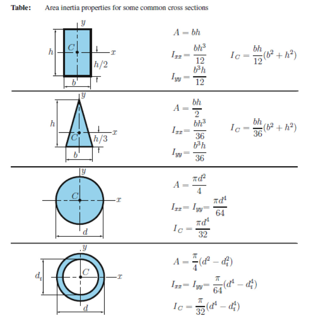

When taking a cross-section of the flagpole, let’s imagine the shape as a solid extruded cylinder or a hollow cylinder.
As such, to increase the area moment of inertia factory, we would increase the diameter in the case of a solid base, or increase the width for a hollow base.
