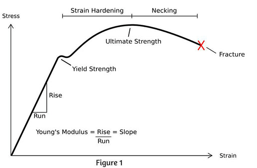

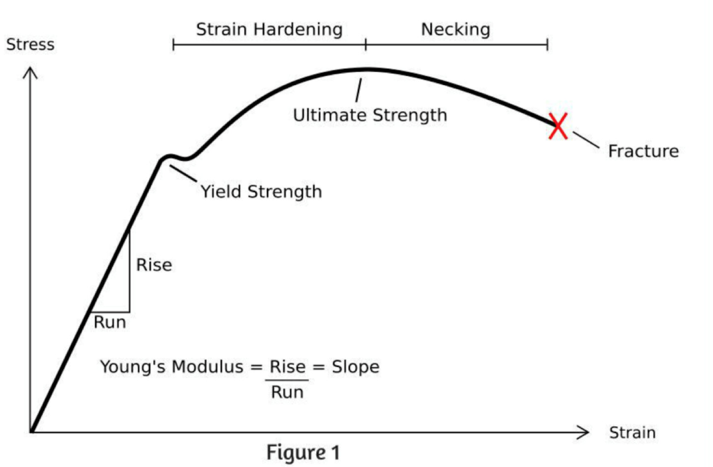

Strength: Measures how much stress can be applied before material deforms permanently/fractures
Stiffness: Measures the resistance to elastic deformation (i.e. non-permanent deformation, will return to original shape)
The Young’s Modulus measures the stiffness in a material, and strength is a function of the modulus. Objects with a high stiffness will resist changes in shape when being acted on by a physical force.

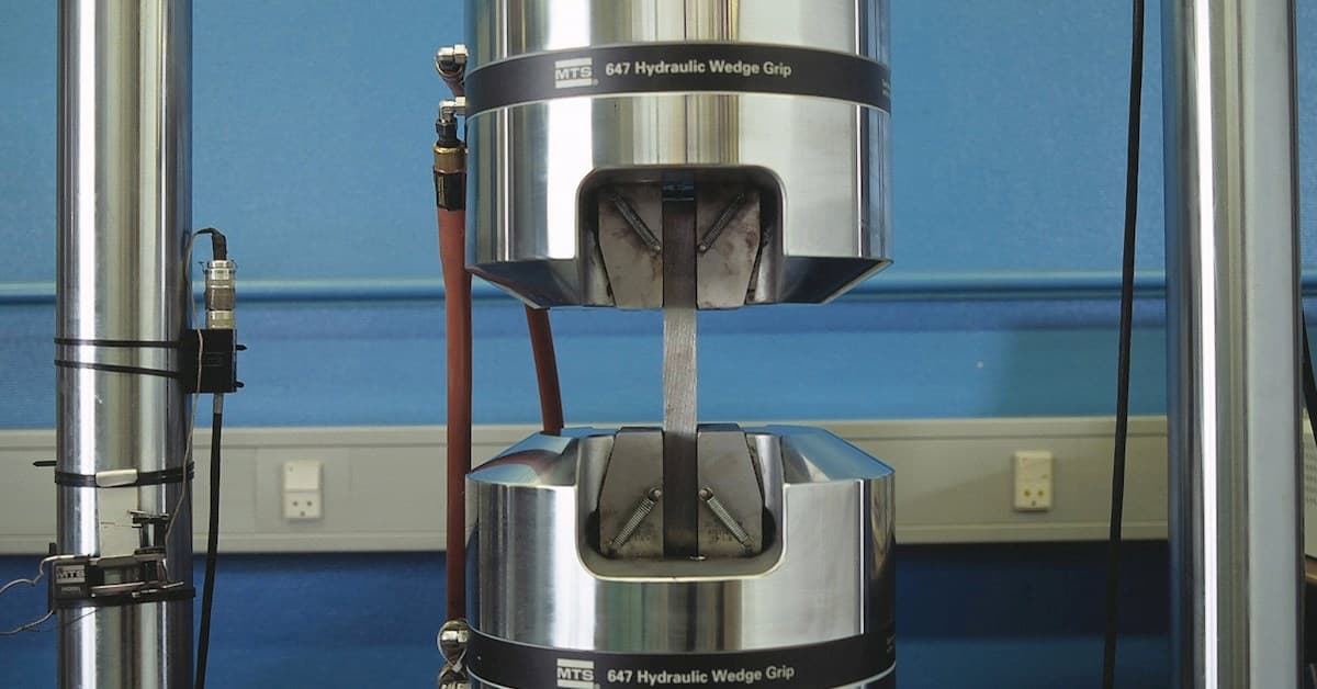

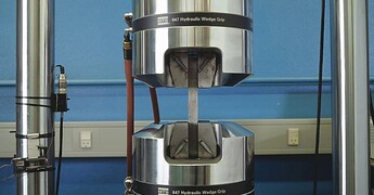

Imagine a metal bar and rubber-like polymer bar loaded under tension and pulled until the specimen fractures.
Metal Bar: Fractures at 100 lbf, deforms 1% of original length
Rubber-Like Bar: Fractures at 100 lbf, deforms 10% of original length
Both materials here are equally strong, but the metal is much stiffer than the rubber polymer. Here, the metal deflects less for the same loading conditions.
