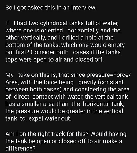

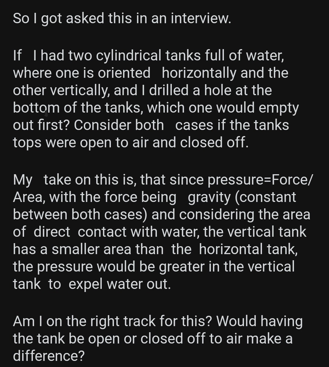

Two cylindrical tanks are full of water, where one is oriented horizontally and another vertically. If a hole is drilled in the bottom of the tank, which one empties first?
Can we look at this as potential energy being converted into kinetic energy? Vertical tank will have more potential energy than horizontal tank, and it would push water out faster.
