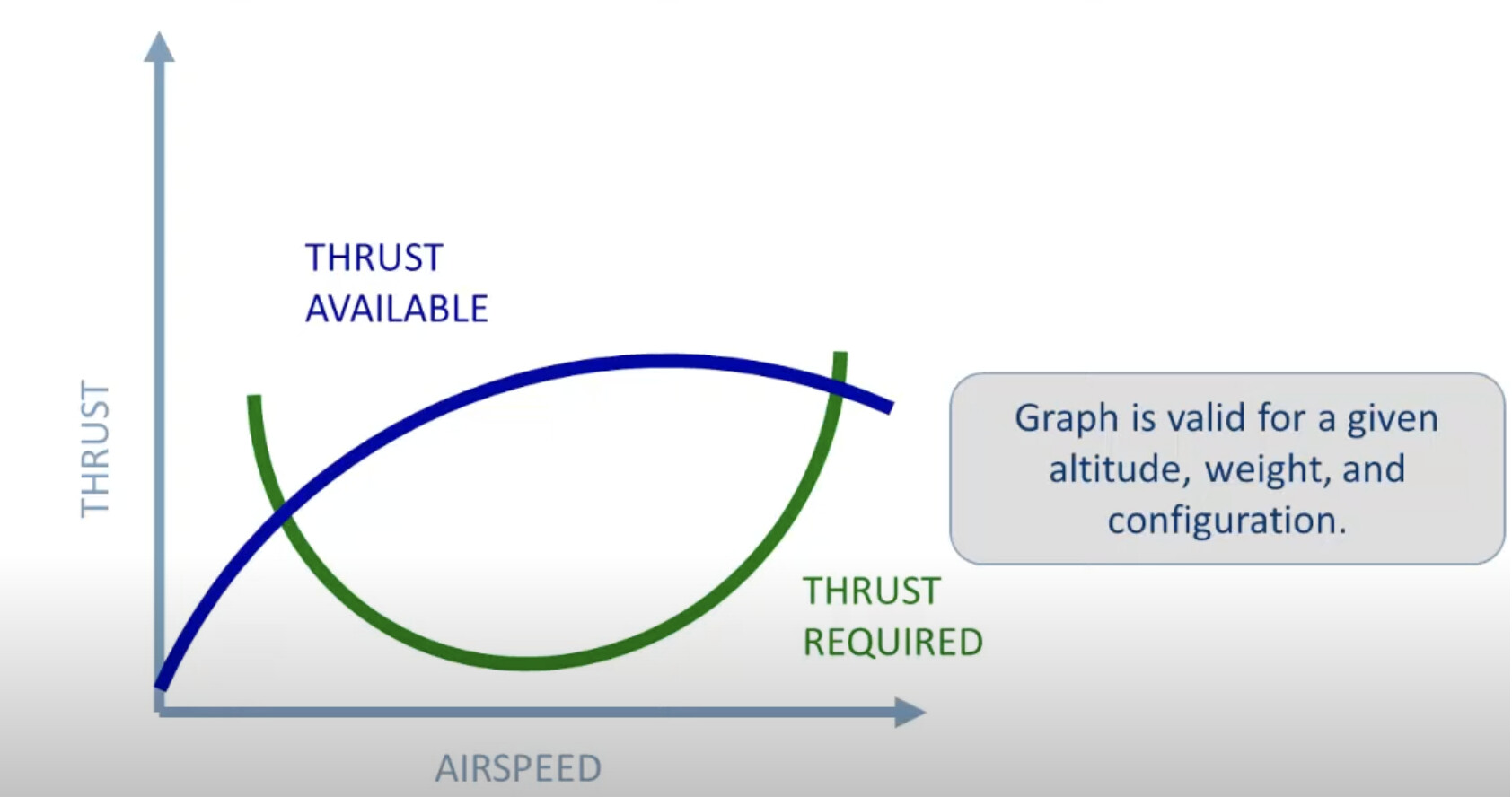

You’re given a thrust curve and basic information on an aircraft as followed for example: (Thrust Available is thrust via propellor and Thrust Required is total drag)

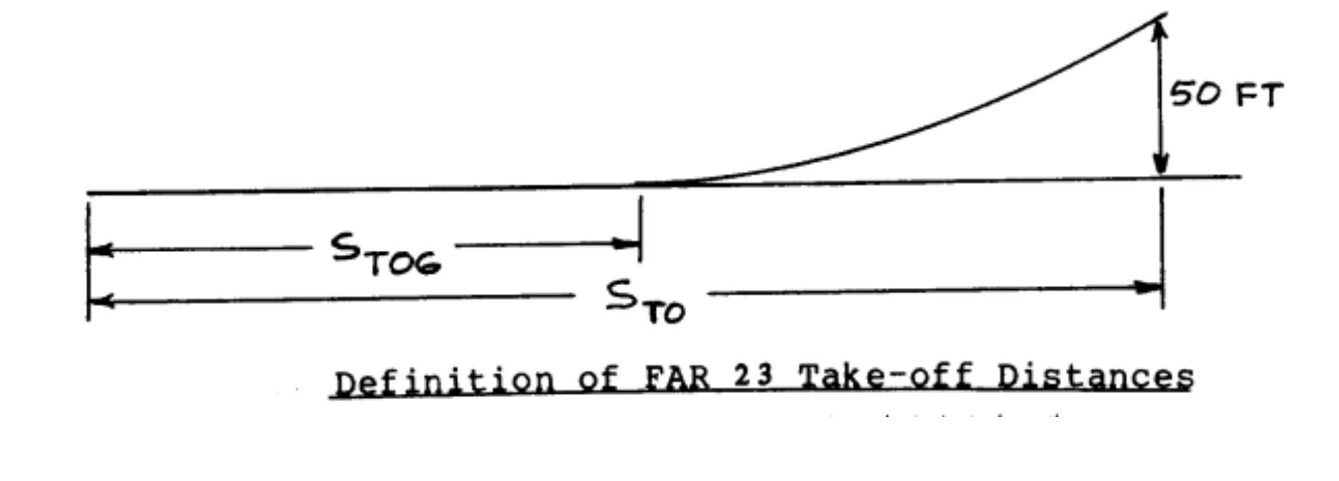

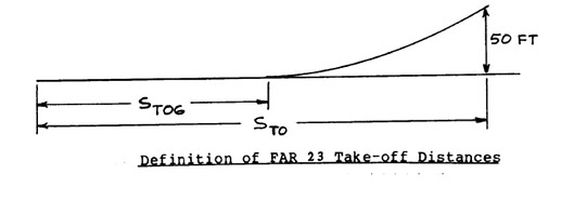

Takeoff distance is the horizontal distance an aircraft needs to reach a height of 50 feet.

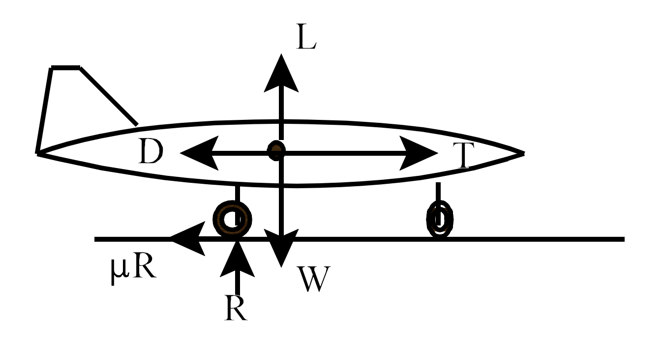

FBD:
The primary forces are Lift (function of velocity), Normal (<=weight), Thrust (from curve), Drag (from curve), and Weight (constant):
Source
We’ll neglect rolling friction in this case and assume the airplane remains relatively horizontal during this process.

Thrust - Drag = F(v) = m * a
Thrust and Drag are given in the curve as a function of velocity. It you know the equations, you can subtract the two or can approximate them (some form of C(v-a)^2+b perhaps) and get a function of force in terms of v. So:
