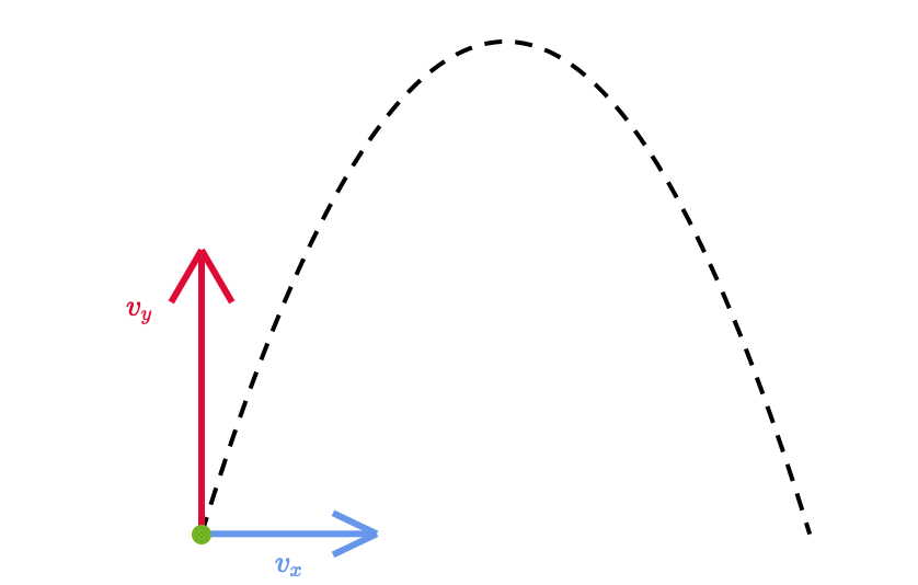

Looking at the basic outline, this reminds me of a 2-D Projectile Motion scenario. In 2-D Projectile motion shown in the image below, you can break down the fundamental equations into two 1-d equations for velocity in the horizontal axis, and velocity in the vertical axis.
Gravitational force will pull downward, affecting the vertical component of velocity at the inflection point. Air resistance is typically considered negligible when solving these problems. However, if you’re assuming air resistance is not negligible, this resistance will cause a horizontal acceleration slowing down the horizontal motion.
The governing equation for this problem (without air resistance) would be:
Thinking through this question and assuming I want to maximize the horizontal travel distance, the key factors here would be to:
