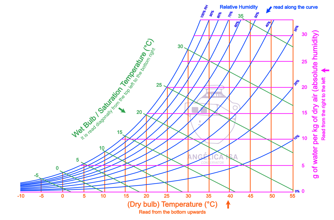

A great visual representation can be seen by reading psychrometric charts (they appear scary, but once you can understand the graph it’s remarkably intuitive!).
The key points are as follows:
- Dry Bulb Temperature: Ambient temperature
- Dew Point: Temperature where water vapor condenses out of the air (100% relative humidity line)
- Absolute Humidity: Actual amount of water that can be “held” by air regardless of temperature
In the case where we go from hot air (i.e. 30 C) to the cold glass (10 C), assuming the same relative humidity of the air (50%), you can see how the absolute humidity of the air changes from ~16 g/kg to ~7 g/kg, and the dew point drops from 21 C to 10 C.
