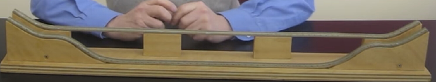

You have two pucks that are slid across a frictionless horizontal surface at the same initial speed, one puck passes over a large dip in the surface. Which one reaches the end of the track first?
Both pucks start at the same speed and time on a frictionless track. One goes down and up a large dip and then returns to the same starting height. Which one arrives to a finish line first?

Breaking down the question, let’s separate the pucks as two distinct scenarios:
Puck 1
  • Travels horizontally along a frictionless surface with no change in potential energy (PE) or kinetic energy (KE)
  • Initial velocity will be the same as final velocity (no friction)
v_i = v_f
Let’s assume puck 1 initial velocity is equal to 2 m/s.
Puck 2
  1. Travels horizontally along frictionless surface, (1)
v_i = 2 m/s
  1. Travels down the ramp, PE converted into KE (2)
PE_0 + KE_0 = PE_1 + KE_1
mgh + 1/2mv_i^2 = 0 + 1/2mv_1^2
v_1 = \sqrt{2(gh + 1/2v_i^2)}
Let’s plug in the following numbers as h = 1 m, g = 9.81 m/s^2, and we’ll find that v1 is equal to 4.86 m/s .
  1. Travels back up the ramp, experiences negative PE and returns to same starting velocity (3)
v_f = v_i = 2 m/s
Because puck 2 experiences increased horizontal velocity while traveling down the ramp, it will reach the end of the track first.
This video here provides a great visual explanation, and how the increased horizontal velocity from the downward dip (potential energy → kinetic energy) translates into the puck with the dip reaching the end of the track first.
