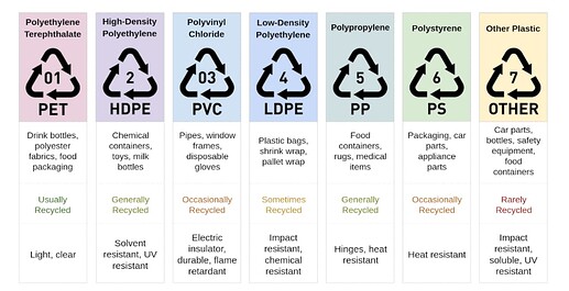

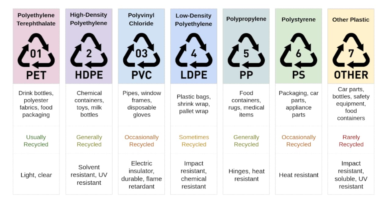

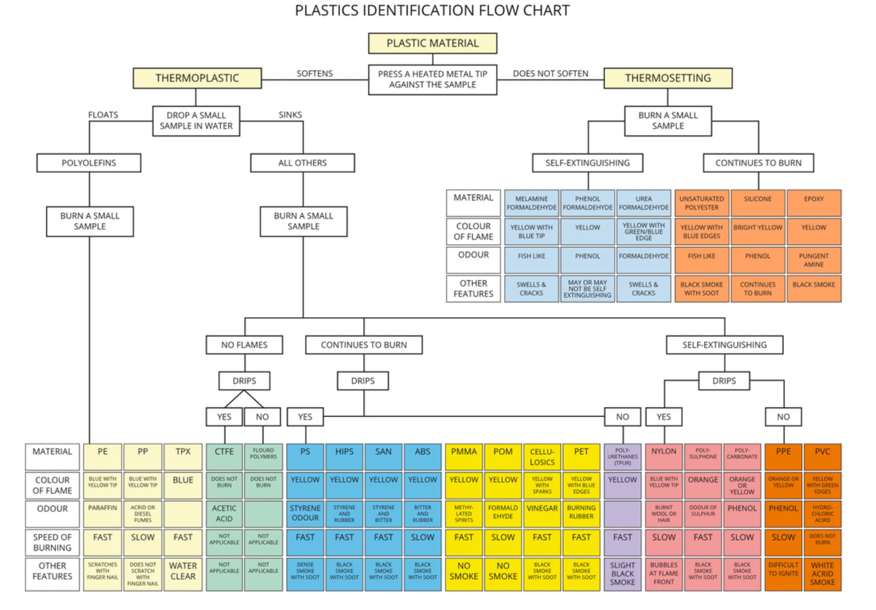

- Utilizing unique behaviors and properties such as density can help determine which type of plastic is being dealt with. Some plastics (PP, PS, PETE) are labelled with a numerical marker on the surface for recycling purposes. Below are two good charts describing this:
Source
Source
